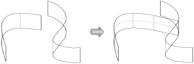

Connection Type
Example
2D object extended to boundary object
2D object trimmed at boundary object
NURBS surface to NURBS surface
Multiple selection connecting 2D objects to boundary object
