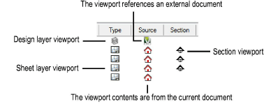

The Viewports tab of the Organization dialog box differentiates among the various types of viewports.
