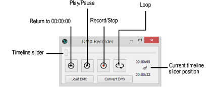

The DMX Recorder
Vision allows real-time recording of the incoming Digital Multiplexed (DMX) stream. This recorded DMX stream can be used to playback lighting looks and sequences when no controller is connected.
To open the DMX Recorder:
Select Window > DMX Recorder.
The DMX Recorder is a separate application that opens along with Vision.

  3. Click Record.
  4. Send the DMX stream to Vision. All DMX values are recorded as they are received; any subsequent cues or effects played on the lighting console will be recorded.
  5. Click Record again to stop the recording.

  3. Click Play.
  4. The DMX file plays within the Vision application window, replacing the current view in the Scene window.
  5. To pause the playback, click Play again. The Scene window returns to the former display of its contents. Click Play to resume the playback.
  6. At the end of the timeline, playback stops and the Scene window returns to the former display of its contents, unless Loop mode is enabled. Looping playback continues until Loop is disabled or the playback is paused.

  3. Click Loop to enable looping mode.
  4. Click Play.
The DMX file begins playback. At the end of the timeline, playback loops back to the beginning and plays continuously until Loop is clicked again to toggle off Loop mode.
