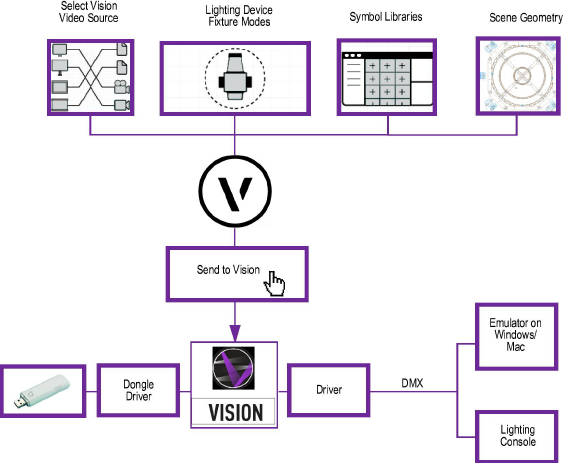

Vision software is designed to work with Vectorworks Spotlight software, although Vision can also be used as a stand-alone product. For information on Vectorworks, please visit vectorworks.net. For information on using the Vectorworks program, please refer to the Vectorworks online help system.
