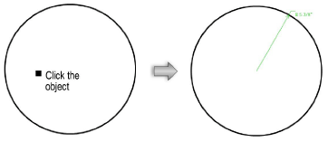

  3. Click the arc or circle to be constrained.
A green radius constraint is drawn on the object.
