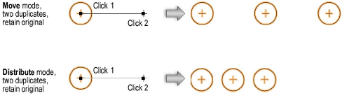

Mode |
Number of |
Original Object Retained |
Result |
Move or Distribute |
0 |
not applicable |
Moves the original object(s) to the location specified by clicking |
1 |
No |
1 |
Yes |
Creates one duplicate of the original object(s), placed at the location indicated by clicking |
Move |
> 1 |
No |
Moves the original object(s), placing the original at the location specified by the first click, and placing the duplicates the same distance apart from each other along the vector created by the two click points |
Move |
> 1 |
Yes |
Creates duplicates of the original object(s), placing the first duplicate at the location specified by the second click, and placing additional duplicates the same distance apart from each other along the vector created by the two click points |
Distribute |
> 1 |
No |
Moves the original object(s), placing the original at the location specified by the first click, and distributing the duplicates between the two click points, and along the vector created by the two points |
Distribute |
> 1 |
Yes |
Creates duplicates of the original object(s), distributing the duplicates between the two click points, and along the vector created by the two points |
Click once (anywhere on the drawing) to indicate the vector start point, and click again to indicate the vector end point. Duplicates are placed in the vector direction, at the distance specified by the click points, along the line defined by the click points.

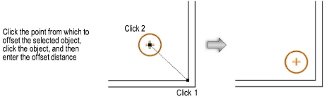

Reference Point mode can work two ways; the first click can either indicate the object to be moved or the reference point from which the object will be offset.
To move selected objects using a reference point:
Select the objects to move.
Click the Move by Points tool from the Basic palette.
To change the selected objects, press and hold the Alt key (Windows) or Cmd key (Mac) while you Shift-click or click-drag to select the objects. The Selection tool is activated in boomerang mode while the Alt or Cmd key is pressed.
Click the Reference Point mode from the Tool bar.
Click to indicate either the reference point, or a point on the selected object.
The Enter Offset dialog box opens.
The current Offset distance between the two click points displays. Enter the desired distance.
Select whether the first click made was the reference point or a point on the object to be moved.
Click OK. The selected object is moved as specified, along the line defined by the click points.
