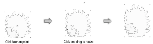

  4. Click the point in the drawing to serve as the fulcrum.
  5. To scale the resized object symmetrically, select a fulcrum point that is at the exact center of the object.
    If the fixed point is not at the center of the object, the resized object changes proportions.
  6. Click an object edge and drag the object into its new size, shape, and/or location.
If the drag point is moved past the selected fulcrum, the object is reversed.
The starting point for dragging cannot be the same as the fulcrum point or exactly horizontal or vertical to it.
