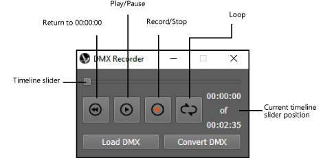

  1. Click Record on the DMX Recorder.
  2. Send the DMX stream to Vision. All DMX values are recorded as they are received; any subsequent cues or effects played on the lighting console will be recorded.
  3. Click Record again to stop the recording.
The Save DMX dialog box opens. Specify a name and location for the .dmx file. The saved DMX file is currently loaded by default and is ready to play, or it can be loaded and played by selecting it with Load DMX.

  1. Click Load DMX on the DMX Recorder.
  2. The Open DMX dialog box opens.
  3. Select the .dmx file to open.

  1. Click Play on the DMX Recorder.
  2. The DMX file plays within the Vision application window, replacing the current view in the Scene window.
  3. To pause the playback, click Play again. The Scene window returns to its former display. Click Play to resume the playback.
  4. At the end of the timeline, playback stops and the Scene window returns to its former display, unless Loop mode is enabled. Looping playback continues until Loop is disabled or the playback is paused.
  2. The Scene window pauses; the DMX signal input continues, but DMX playback from the file is paused.
  3. Click Play again. DMX playback from the file resumes in the Scene window.

  1. Click Loop on the DMX Recorder.
  2. Click Play.
The DMX file begins playback. At the end of the timeline, playback loops back to the beginning and plays continuously until Loop is disabled.
