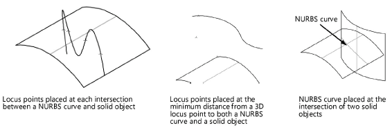

In Proximity mode, the Analysis tool places a 3D locus at the minimum distance or intersection between two solid objects, and a 3D locus and NURBS curve or surface. The tool places a NURBS curve at the intersection of two solids.
To analyze solids’ proximity or intersection:
  1. Click the tool and mode.
  2. Click on a NURBS curve, NURBS surface, solid object, subdivision object, or 3D locus, and then click on another solid object.
A 3D locus is placed on each NURBS curve at the closest minimum distance or intersecting points between the two items, or a NURBS curve is placed at the intersection of two solids.

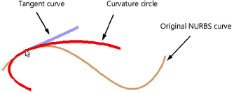

  2. Click on the NURBS curve of interest, and then move the cursor along the curve to display the curvature circle (in red) and tangent curve (in blue) at the cursor position.
  4. Click the curve to obtain curve properties at a specific location along the curve. The Curve Properties dialog box opens, displaying curvature parameters for that location.
  5. To add a curvature circle or tangent curve to the drawing, select the appropriate options. If you select multiple items, they are created as a group.

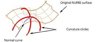

  2. Click on the NURBS surface of interest and move the cursor along the surface to display the curvature circles (in red) and normal curve (in blue) at the cursor position.
  4. Click again to obtain surface properties at a specific location along the surface. The Surface Properties dialog box opens, displaying curvature parameters for that location.
  5. To add curvature circles or a normal curve to the drawing, select the appropriate options. If you select multiple items, they are created as a group.
