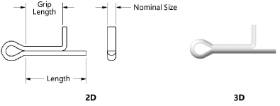

Cotter Pin Type
Select square cut or hammer lock
Nominal Size
Select the nominal size in inches
Grip Length
Enter the grip length
Length
Enter the pin length
Bend Angle (Top)/(Bottom)
Enter a bend angle in degrees for the top and/or bottom section of the cotter pin
View
(2D only)
Select the 2D view
