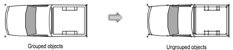

Ungrouping
The Ungroup command ungroups objects or groups that were previously combined with the Group command. Nested groups must be ungrouped one at a time.
To ungroup a group of objects:
1. Select the group to ungroup.
2. Select Modify > Ungroup.
Alternatively, right-click (Windows) or Ctrl-click (Mac) on the group, and select Ungroup from the object context menu.
