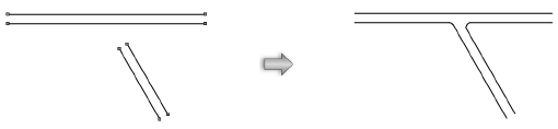

To join and fillet double lines:
1. Select the two sets of non-parallel double lines to join.
2. Select Modify > Join > Join and Fillet.
If a fillet measurement has already been specified for this drawing, the two double lines are connected and filleted using the default value.
If a fillet measurement has not yet been specified for this drawing, the Fillet Settings dialog box opens.
Enter the desired fillet radius and click OK to connect and fillet the lines.
