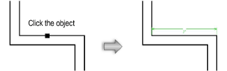

To constrain the horizontal distance of an edge of an object or a line segment:
Click the Constrain Horiz Distance tool from the Dims/Notes tool set.
Click the object to be constrained.
A green horizontal distance constraint is drawn on the object.

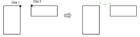

To constrain the horizontal distance between two points:
Click the first point to be constrained.
The cursor switches to the bull’s-eye cursor.
Click the second point to be constrained.
A green horizontal distance constraint is drawn between the two points.
