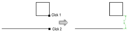

To constrain the vertical distance between two points:
Click the Constrain Vertical Distance tool from the Dims/Notes tool set.
Click the first point to be constrained.
The cursor switches to the bull’s-eye cursor.
Click the second point to be constrained.
A green vertical distance constraint is drawn between the two points.
