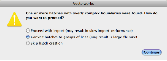

  8. If the file being imported has one or more complex hatches with multiple boundaries, the import may have performance problems. An alert displays to allow you to choose how to process the hatches. Select an option and click Continue. If you select the option to convert hatches to groups of lines, solid type hatches will be skipped rather than imported.
  9. For batch imports, no alert displays; the last option you selected from this dialog box for single file import is used by default.
