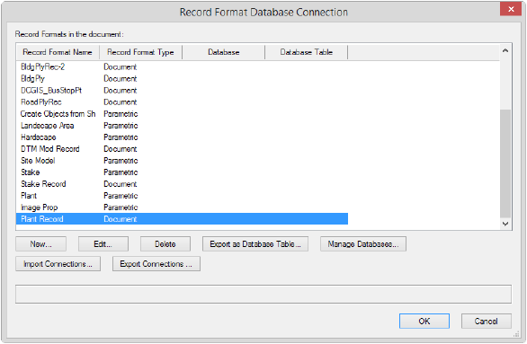

  1. Select Tools > Database > Record Format Connection.
  2. The Record Format Database Connection dialog box opens, listing the record formats available in the current file.
  3. Select the record format, and then click Export as Database Table.

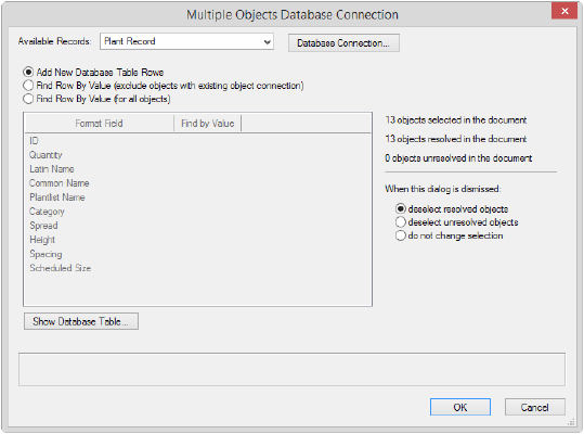

  11. Select Tools > Database > Object Connection.
  12. Since several objects were selected, the Multiple Objects Database Connection dialog box opens.
  13. Select the applicable record from the Available Records list, and then select the Add New Database Table Rows option.
  14. Click OK.

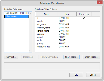

  15. To verify that the database rows exist and have been populated with data, select Tools > Database > Manage Databases. The database rows have been created for the selected record format.

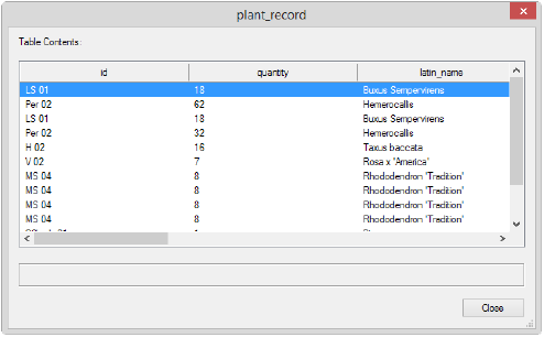

  17. Click Show Table.
  18. A dialog box opens, showing the database table for the associated record format.
  19. The objects with the record are connected to the rows of the database table. The table is filled with data from the record formats of the objects in the drawing.
