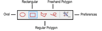

  1. Click the Redline tool from the Dims/Notes tool set, and select a drawing mode from the Tool bar.
  2. Click Preferences from the Tool bar to specify the Redline tool parameters for this session.

  5. On the design layer where the revision is to be performed, draw the redline around the revision area.
  6. Based on the selected creation method, the appropriate tool creates the redline. This allows the use of SmartCursor cues, object snapping, and boomerang mode when drawing redlines.
