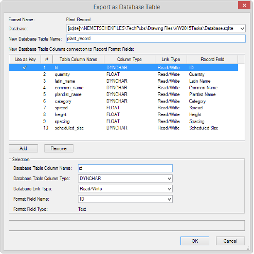

Select the record format, and then click Export as Database Table.
The Export as Database Table dialog box opens.
Click to show/hide the parameters.
Specify the parameters of the database table columns to be created. The columns will be created in the order listed; to change the order of a database table column, click and drag within the # column.
Click Close to return to the Export as Database Table dialog box and make any further necessary table column adjustments.
Click OK.
