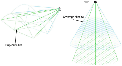

Show Dispersion Range 1/2/3 |
Draws the top, bottom, left, and right dispersion lines, along with a center reference line, for each of the three dispersion ranges selected for display (or the Overall range if expanded dispersion is not selected). An outline or hatch pattern representing the listening area coverage “shadow” is drawn when the throw distance and the vertical dispersion and tilt angles allow the speaker to cover the area at or below the Listening Height.
Show Dispersion Hatch |
Displays hatch fills in the coverage shadow of each enabled dispersion range |
