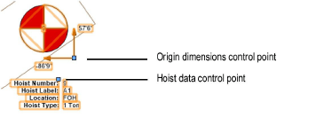

The hoist’s graphical representation in Top/Plan view depends on whether the hoist motor is up or down, as well as its load rating and its manufacturer or function. Hoist symbols, which can be customized, are available in the Vectorworks Libraries\Defaults folder; a selected hoist symbol is automatically imported into the current file and displays in the Resource Manager; see Resource Manager. The display of the hoist number, dimensions, and labels can be adjusted from the Object Info palette, and with the Set Hoist Number and Dimension Display command, or by making the associated number or label class invisible.

X/Y |
Displays the X and Y coordinates of the hoist relative to the selected hoist origin; these coordinates display graphically on the hoist when Relative X, Y On Plot is selected |

Data Display X/Y |
Specifies where to place the hoist data; the X and Y distances are relative to the center of the hoist object |
Relative X,Y On Plot |
Displays the coordinates and the direction relative to the hoist origin selected in Measure From |
Dim Display X/Y |
Specifies where to place the coordinates and dimension lines of the hoist origin distance indicator; the X and Y distances are relative to the center of the hoist object |
