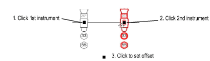

To gang two or more instruments:
  1. Click the Ganging tool from the Spotlight tool set.
  2. Click Preferences from the Tool bar to set the default tool preferences, if desired.
  3. Click the first, and then the second, instrument to be ganged together. If more than two instruments are to be ganged together, continue clicking on each instrument in succession.
  5. Click to set the offset distance of the two-fer label.
  6. If the field values of the instruments do not match, confirm that this is acceptable in the Notice dialog box which opens.
  7. Click OK. The instruments are ganged together with one or more two-fer objects.
