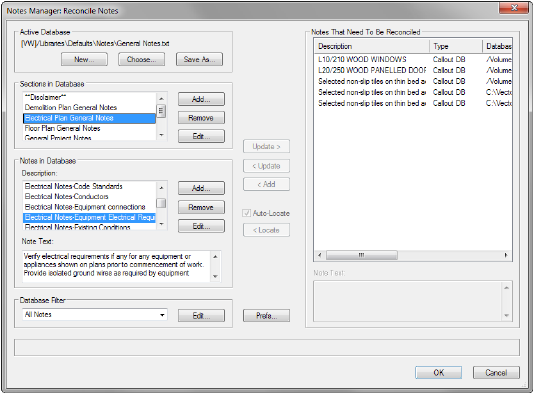

  11. If some notes have still not been located, the Notes Manager: Reconcile Notes dialog box opens.
  12. The dialog box is divided into two sections, with the database information on the left and the notes to be reconciled on the right. The buttons in the center of the dialog box move information from the database to the general notes and vice versa.
    By using the center buttons, reconcile each note manually. As a note is reconciled, it is removed from the list.
  13. Click OK.
An alert message explains how the notes were reconciled.
