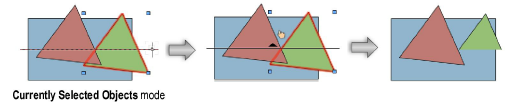

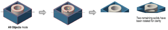

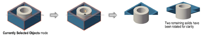

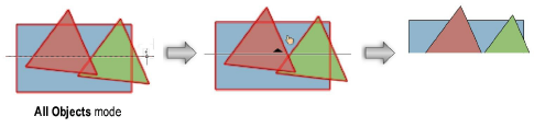

  3. Click the All Objects or Currently Selected Objects mode from the Tool bar.
  4. Draw a line through the object to split; the object to be split is highlighted.
  5. An arrow points to the side to be kept. Click to indicate which side of the split line to keep; the other side is trimmed away.
The object is split by the line, and the indicated side remains.
Solids can also be split in Line Trim mode.
