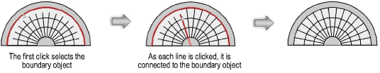

To connect multiple objects to a boundary object:
  1. Click the Connect/Combine tool from the Basic palette, and select Multiple Object Connect from the Tool bar.
  2. Click the boundary object, which becomes highlighted in red.
  3. Position the cursor over the first object to trim or extend to the boundary; it becomes highlighted in red. Click to resize the object to join the boundary object.
  4. Continue to click on objects to connect to the boundary. Each consecutively clicked object is connected, until you click in an empty space to deselect the boundary object.
