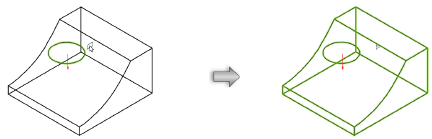

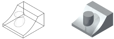

  1. In the desired view, draw a 2D object or NURBS curve on top of a solid object.
    The 2D object or NURBS curve must be closed and planar.
  3. Click the Project tool from the 3D Modeling tool set.
  4. Select Add from the Tool bar. Select the appropriate direction mode so that the projection direction intersects the solid object (Add Upward, Add Downward, or Add Both Directions).
  5. The projection direction must intersect with the solid object, or no projection is created.
  6. Click on the object to add; the projection direction is indicated by a red arrow. Click on the solid object
The 2D object’s projection is added to the solid object at the point of intersection, creating a generic solid.
