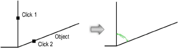

  3. Click one of the two objects or line segments to be constrained.
  4. The cursor switches to the bull’s-eye cursor.
  5. Click the second object or line segment to be constrained.
A green angle constraint is drawn between the two objects or line segments.
