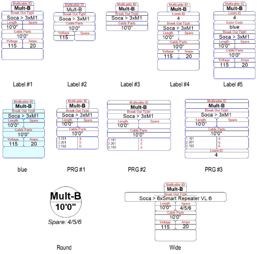

Multicables can be automatically labeled with break out information that shows multicable circuiting information. A variety of labels are available by default; custom labels can also be created.
To label multicables with break out information:
If adding labels to specific multicables, select the multicable objects. To add labels to all multicables, do not select any multicables.
Select Spotlight > Cables > Place Break Out Labels.
If no multicables are selected, confirm that you want to label all multicables. The Place Break Out Labels dialog box opens.
► Click to show/hide the parameters.
Click OK.
The break out label is created.
Right-click on the break out label and select Select Multicable from the context menu to select the multicable associated with the label.
The break out label properties can be edited from the Object Info palette. Changes made to the label parameters are reflected in the parameters of the associated multicable object.
