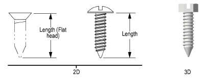

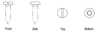

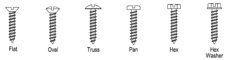

To insert a sheet metal screw (self-tapping screw):
  1. Click the Sheet Metal Screw tool from the Detailing tool set.
  2. The Sheet Metal Screw tool and Sheet Metal Screw - 3D tool share the same position on the tool set. Click and hold the mouse on the visible tool to open the Pop-out Tools list and select the desired tool.
  3. Click to place the object in the drawing, and click again to set the rotation.
The first time you use the tool in a file, a properties dialog box opens. Set the default properties, and click OK. The properties can be edited from the Object Info palette.
