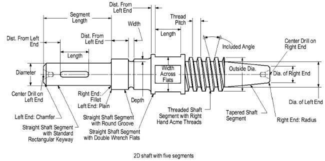

The Shaft tool allows the creation of a shaft consisting of multiple straight, tapered, and threaded shaft segments.

  5. Click the Configuration button from the Object Info palette to add, delete, or modify shaft component segments (see Shaft Segment Properties).
