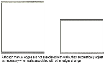

In order to work in a broad variety of construction situations, slabs allow each edge to be either bounded by a wall or manual. If a slab is split, the existing bounded wall associations are maintained for edges that abut a wall, and the newly split edges are manual. Each slab edge can be given a unique component edge offset, as needed.

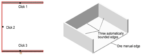

To create a slab that is automatically bounded to existing walls on some edges and manual on others:
  1. Click the Slab tool from the Building Shell tool set, and click Picked Walls mode from the Tool bar.
  2. Do one of the following:
  3.     To use an existing slab style from the resource libraries, click Slab Style on the Tool bar. From the Resource Selector, double-click a resource to activate it. Or, to draw an unstyled slab, leave the <Unstyled> setting as is. Proceed to step 3.
        To create a custom slab style, click Preferences from the Tool bar. From the Slab Preferences dialog box, set the default properties (see Creating Slab Styles) and click OK. The properties can be edited from the Object Info palette.
  4. Click each wall that forms the wall set and press Enter, or click the check mark button on the Tool bar.
The slab is created; manual edges are automatically created as needed to complete the slab’s geometry.
