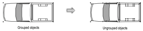

The Ungroup command ungroups objects or groups that were previously combined with the Group command. Nested groups must be ungrouped one at a time.
To ungroup a group of objects:
