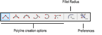

Mode
Description
Polyline creation options
Specifies the method for drawing the polyline shape for the shadow
Fillet Radius
Sets the fillet radius when the Arc Vertex mode is selected
Preferences
Opens the object properties dialog box to set the default preferences for camera match shadows

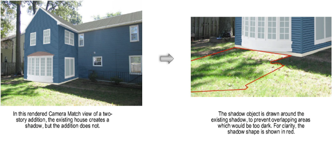

  1. While in the viewport Edit Annotation mode, click the Camera Match Shadow tool from the Visualization palette, and draw a polyline object over the area of the model that needs a shadow.
  3. The Camera Match shadow is created.
