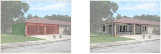

A preview object contained within the Camera Match object helps establish the Camera Match view. This object is made up of two vertical planes placed in relation to the reference object. One vertical plane is green and vanishes toward the left vanish point; the other plane is red and vanishes toward the right vanish point. This object always displays in the perspective view calculated by the Camera Match object, according to its current settings. This provides a live preview as adjustments are made, making it easier to set the parameters and control lines accurately.
While the default settings may not relate to the size of objects in the photo, they can be used to get a good feel for how the perspective view is shaping up as control lines and settings are changed in the Camera Match object. However, if you know the size of an existing object in the photo, the Preview Object can be set to this size. In the image, the preview object was set to the dimensions from the corner to two columns wide and two columns deep. This also happens to be the extents of the proposed parts of the model. You can see just how well the view is aligning with the photo before actually clicking Set View to Match. Keep in mind that the preview object is only an aid to help with setting the parameters of the Camera Match object. While it is good to try to set up the Camera Match object so that the preview object aligns well with the photo, it is not critical to align it perfectly. Once it is close, click Set View to Match. You can always tune the view to further refine it.
When you click Set View to Match (or Fine Tune View), the preview object is turned off and the model view is set (as shown in the image to the right).
