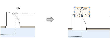

A label can be placed to mark the specific distance from the start of the cable to a point clicked on the cable.
To mark a clicked distance on a cable:
  1. Select the command.
  2. Click on the cable at the point where the measurement marker should be placed.
  3. The Enter Value dialog box opens.
  4. If the cable travels vertically, enter the vertical distance; otherwise enter 0 (zero).
The distance marker is placed on the drawing.
