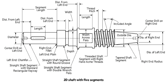

The Shaft tool allows the creation of a shaft consisting of multiple straight, tapered, and threaded shaft segments.
