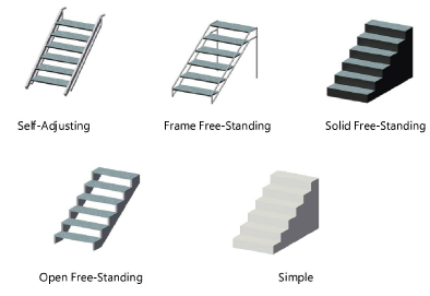

Structure |
Select the style of stage steps; self-adjusting steps have a fixed stringer length and number of steps, and the step rise automatically adjusts to fit the stage height. For the other types of steps, the step parameters are determined according to the selected Create Based On option.
