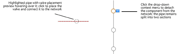

When adding irrigation components to an existing network, the component to connect to is highlighted, indicating that if placed there, the new component will connect to the network. Components placed on pipes split the existing pipe into two pipes, as they would in the real world. Controllers cannot be connected to a network.
Selecting a valid irrigation component displays a drop-down context menu. Pipes have a drop-down context menu at each end. Select the drop-down context menu to access the Detach From Pipe Network command. When a component is detached from the network, it can be moved without affecting other networked objects. A warning in the Object Info palette indicates that the object is not connected to a network; to reconnect it, drag it over its connecting pipe and drop it when the pipe is highlighted.
