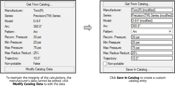

When placing an irrigation object from a manufacturer’s product series into the drawing, the manufacturer’s parameter values display in the Object Info palette. The data cannot be edited directly, because the calculations assume the usage of the manufacturer’s products and specifications.
In some cases, the manufacturer’s data may need to be modified. To edit the data, click Modify Catalog Data from the Object Info palette of a selected object. To save the modified data for re-use as a custom catalog entry, click Save In Catalog.
When you modify the catalog data, the performance data is removed. To avoid this, access the catalog and duplicate a catalog entry, and then modify the data for the duplicate. See Managing the Irrigation Catalog.
The data of a selected object can be modified without affecting the catalog data, and the object can be saved with its modified data (including other Object Info palette settings like the Name and Graphics settings). Click Save [object name] from the Object Info palette and enter a name to create a red symbol definition, which can be accessed from both the Resource Manager and Resource Selector.
If placing a custom irrigation object, rather than a manufacturer’s object, into the drawing, you can either specify your own data, or click Get From Catalog from the Object Info palette of the selected object to fill in performance data from the catalog.
