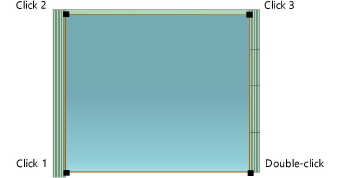

To create a hydrozone:
Click the tool and the appropriate mode to specify the creation method of the hydrozone.
Alternatively, create a polyline and then select the Create Objects from Shapes command (see Creating Objects from Shapes).
Click once to set the hydrozone location, and then draw the hydrozone polyline, clicking at each vertex. Click at the start point, or double-click, to finish drawing the hydrozone.
The hydrozone properties can be edited from the Object Info palette.
