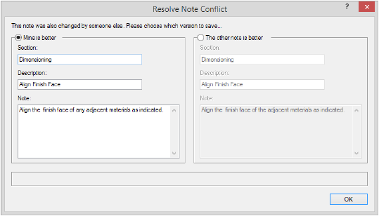

A conflict could arise if you and another user edit the same note in the same database at the same time. If this occurs, the Resolve Note Conflict dialog box opens when you close the Notes Manager dialog box.
On the left, your version of the note displays, and on the right, the other user’s version displays. Select which version of the note to save by selecting Mine is better or The other note is better.
