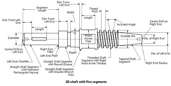

The Shaft tool allows the creation of a shaft consisting of multiple straight, tapered, and threaded shaft segments.
To insert a shaft segment:
1.      Click the tool and mode.
2.      Click to place the object in the drawing, and click again to set the rotation.
3.      Click the Configuration button from the Object Info palette to add, delete, or modify shaft component segments (see Shaft segment properties).
