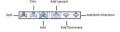

Mode
Description
Split
Splits a solid object with a projection
Trim
Trims a solid object with a projection
Add
Adds a projection to a NURBS surface
Add Upward
In Add mode, adds the projection in the profile plane normal direction
Add Downward
In Add mode, adds the projection in the opposite direction from the profile plane normal direction
Add Both Directions
In Add mode, adds the projection in both the profile plane normal direction and the opposite direction
