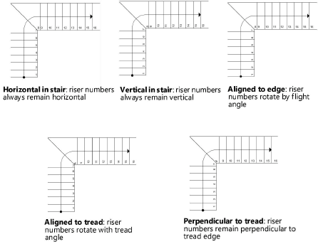

Rotation |
Specifies the rotation of the riser numbers
