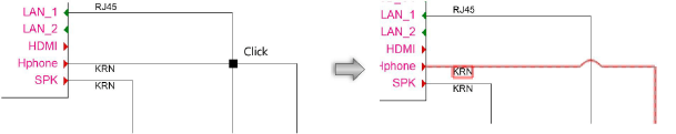

Connect00032.pngCreating a circuit hop over
Tool
Tool set
Hop Over
Schematics
Where two circuits intersect, you can indicate routing priorities with a hop over.
To create a hop over:
1.      Click the tool.
2.      Move the cursor over the circuits; the highlighted circuit is the priority circuit.
Select a circuit first to always make that the priority circuit.
3.      Click on the circuit to create the hop over.
