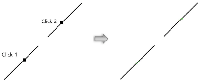

Constrain the collinearity between two linear objects. If one line is moved, the other constrained line adjusts to remain aligned. The lines do not need to be aligned when you place the constraint; the first line moves to become collinear to the second line.
To constrain the collinearity between two lines:
1.      Click the tool.
2.Click the first and then the second line to constrain.
Green collinear constraint indicators are drawn on the two lines.
