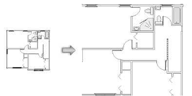

With the Zoom tool selected, double-click anywhere in the drawing to automatically activate the Selection tool.
Double-click the Zoom tool from the Basic palette to double the magnification of the drawing. The Zoom In button on the View bar performs the same action.

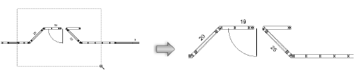

To marquee zoom:
Click the tool and mode.
Click and drag to create a marquee box around the portion of the drawing to magnify.
Click again to zoom in.
Vectorworks magnifies the selected section so that it fills the drawing window.
To zoom out, hold down the Option (Mac) or Alt (Windows) key while you draw a marquee box around a portion of the drawing. Click again to zoom out. The program reduces the magnification to display additional portions of the drawing around the selected section.
