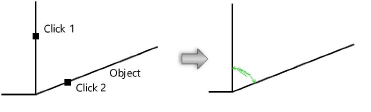

To constrain the angle between objects or line segments of a single object:
Click the tool.
Click one of the two objects or line segments to be constrained.
Click the second object or line segment to be constrained.
A green angle constraint is drawn between the two objects or line segments.
