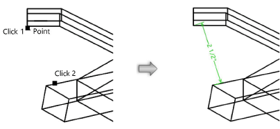

To constrain the distance between two points:
Click the tool.
Click the first point to be constrained.
Click the second point to be constrained.
A green distance constraint is drawn between the two points.
