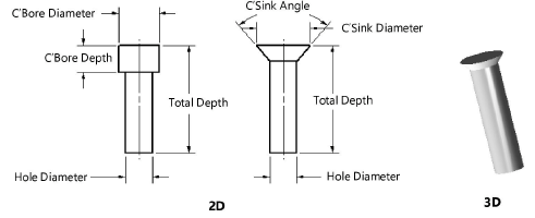

Both 2D and 3D drilled holes are available. The 3D drilled hole is a solid object that can be subtracted from any other solid object to create accurate 3D models of molds, dies, and many other machine parts (see Subtract solids).

Hole Diameter |
Enter the hole diameter |
Total Depth |
Enter the depth of the hole |
Hole Type |
Select one of the hole types
Drill Point Angle |
For Blind Hole types, indicate the angle of the drill point at the bottom of the hole |
Hole Style |
Select the hole style
Diameter |
For counterbored or countersunk hole styles, enter the diameter of the counterbore or countersink |
Depth |
For counterbored hole styles, specify the depth of the counterbore |
Angle (deg.) |
For countersunk hole styles, specify the angle of the countersink |

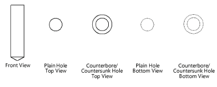

View |
Select the 2D view
Show Center Line |
Draws the 2D drilled hole with center line(s) |
