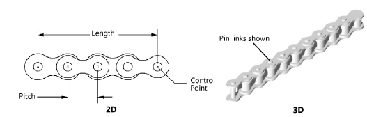

The 2D linear roller chain is a linear object, while the 3D linear roller chain is a point object.

Std. Chain No. (Pitch) |
Select the standard ANSI or ISO roller chain number; the pitch is given as a reference |
Length (2D only) |
Specify the length of the 2D roller chain by entering a value here or by clicking and dragging one of the chain control points; as the length increases, the number of links increases (depending on the selected pitch) |
No. of Links |
Enter the number of links; the length automatically adjusts |
Start with Pin Link |
Begins the chain section with a pin link; otherwise, the section begins with a roller link |
Show Pins (3D only) |
Displays the pins |
